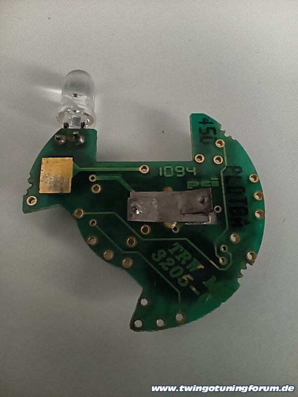

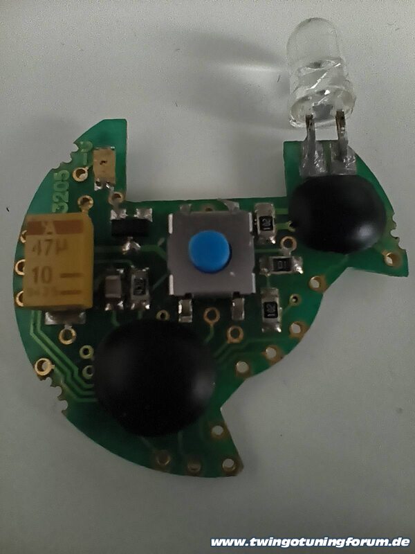

Hi, I have a Twingo 95, no immobilizer, only central locking with ir, it's the round key with round button in the center. I accidentally entered a swimming pool with the key in the pocket and not it doesn't work and I couldn't fix it and find where the problem is. Any suggestion how I can fix it, or find another key? I will have to replace the circuit in the ceiling?

Du kannst auch vorher mal testen ob der Schlüssel noch sendet, halte die Handykamera auf die LED neben den Schlüsselbart u drücke den Knopf des Schlüssels, in der Kamera müsste dann die LED in Lila leuchten, das sieht man nur in dem Kamerabild.
Thanks, it was stupid of me, After cleaning and resoldering, I put the batteries in the wrong direction. After changing direction, button works better than before.
