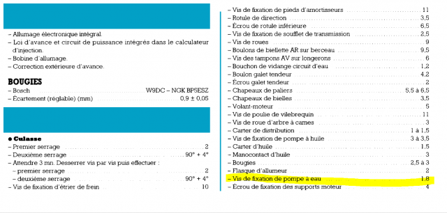

(27.06.2018, 09:25)ronenfe schrieb: [Bild: 2018-010.png]
I mean number 5 nuts.
What do you mean pipe clamps should be hand tighten only? I used tools for everything.

Number 5 has no torque, you turn till the end of the winding,
so the nut is about 1 cm on it.

You were right, it says 18nm but maybe it's a mistake.

I meant to attach this:
#38
So it could be expansion bolts, a print error or 12.9er bolts.

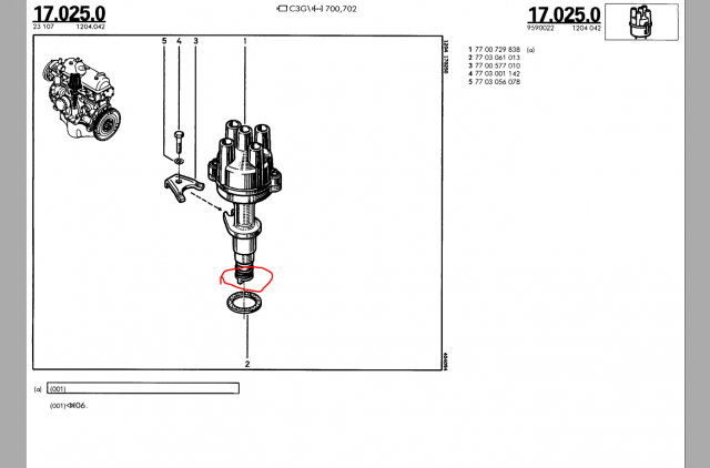

(11.06.2018, 07:29)Broadcasttechniker schrieb: The distributor doesn't have to be fineadjusted because the timing doesn't depend on its position.
So I would remove it.
Does the orientation of the shaft notch matters when I put it back? because It can be put in 180 degrees difference, can't it?
