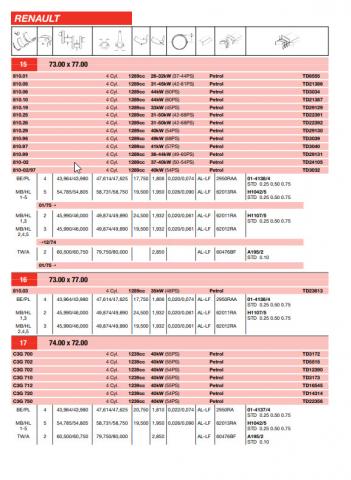

This is the big end bearings which I bought and fit:
http://www.king-catalog.com/Catalog/Set/CR4426AM
Can anyone tell me what's the width of the big end bearing? My old ones were 17.7 mm. So why all manufacturers say it should be 20.75 mm?

I do not see the C3G in the compatibility list for the CR4426AM bearing set.
Besides, if the width is 17,01mm and not 17,7 and not 20,75 either, why did you order it?
Why do you think I wrote the quoted stuff above?
You also have to observe that you don't buy "oversized bearings", usually by 0,25mm ore even more.
The oversized is in quotation marks because they are usually undersized (the bore) and intended to be used together with a revised crankshaft.
http://www.catcar.info/renault/?lang=en&...PT0xMEQ%3D
Don't mix up the main bearings with the big end bearings.
The small size is used with revised crankshafts, the bigger size with the original crankshaft.
Perhaps C1J engine. Look for the engine plate under the cylinder head.
Mine are 17.7 mm same as the King engine I bought. I compared them and they look identical. I bought the standard bearings.
That's what I don't understand, why they say that c3g should have 20.75 mm.

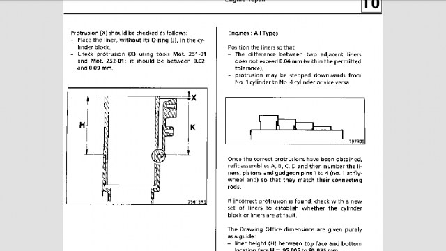

Also, what do they mean? that I'm supposed to change the order of the used liners and their pistons to achieve the correct protrusion?
You don't have to do that if you reuse the old liners because they should have been perfectly aligned in the factory.
The protrusions are wildly exaggerated just to show you how to arrange the liners in case that they are new and different in hight.
